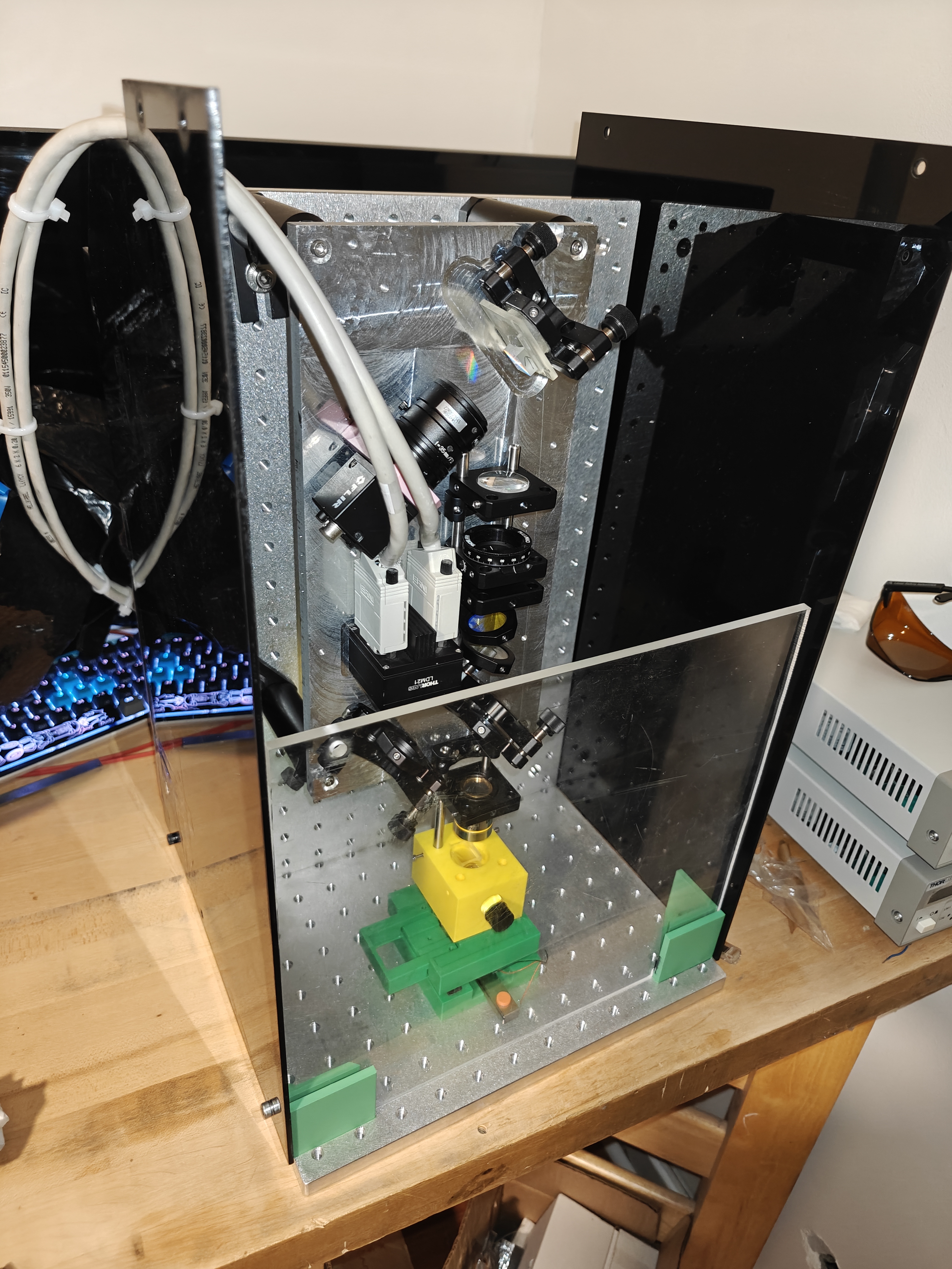

I have another question surrounding my solid powder setup. I chose to mount my Raman spectrometer vertically instead of using the optical components.
IMG20241124185029 (1).jpg (4.38 MiB) Viewed 394925 times

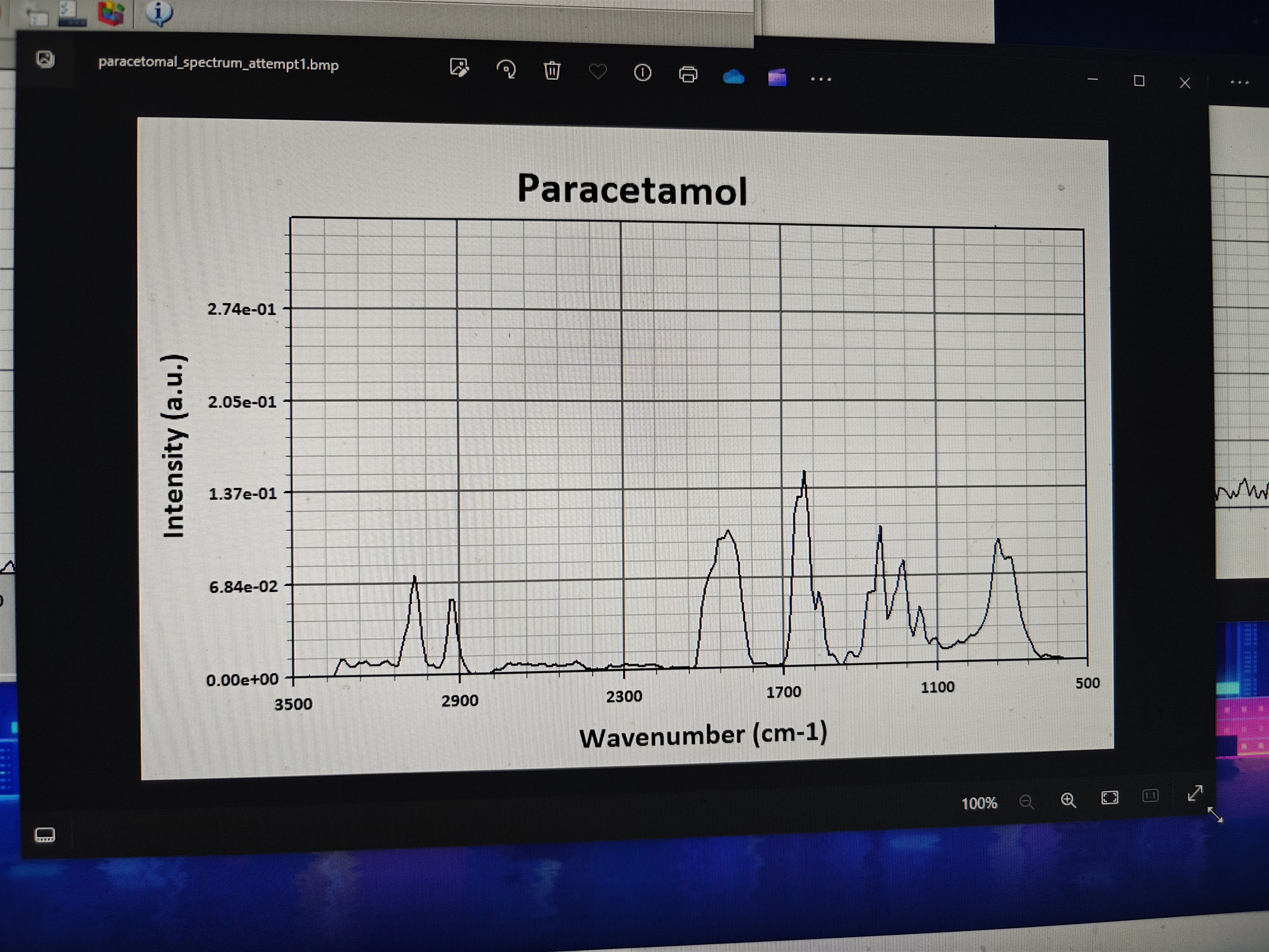

I got a good result for the Paracetamol sample
Though the resolution isn't quite as good since the peaks that are closer to each other are 'absorbed' to form a thicker peak.

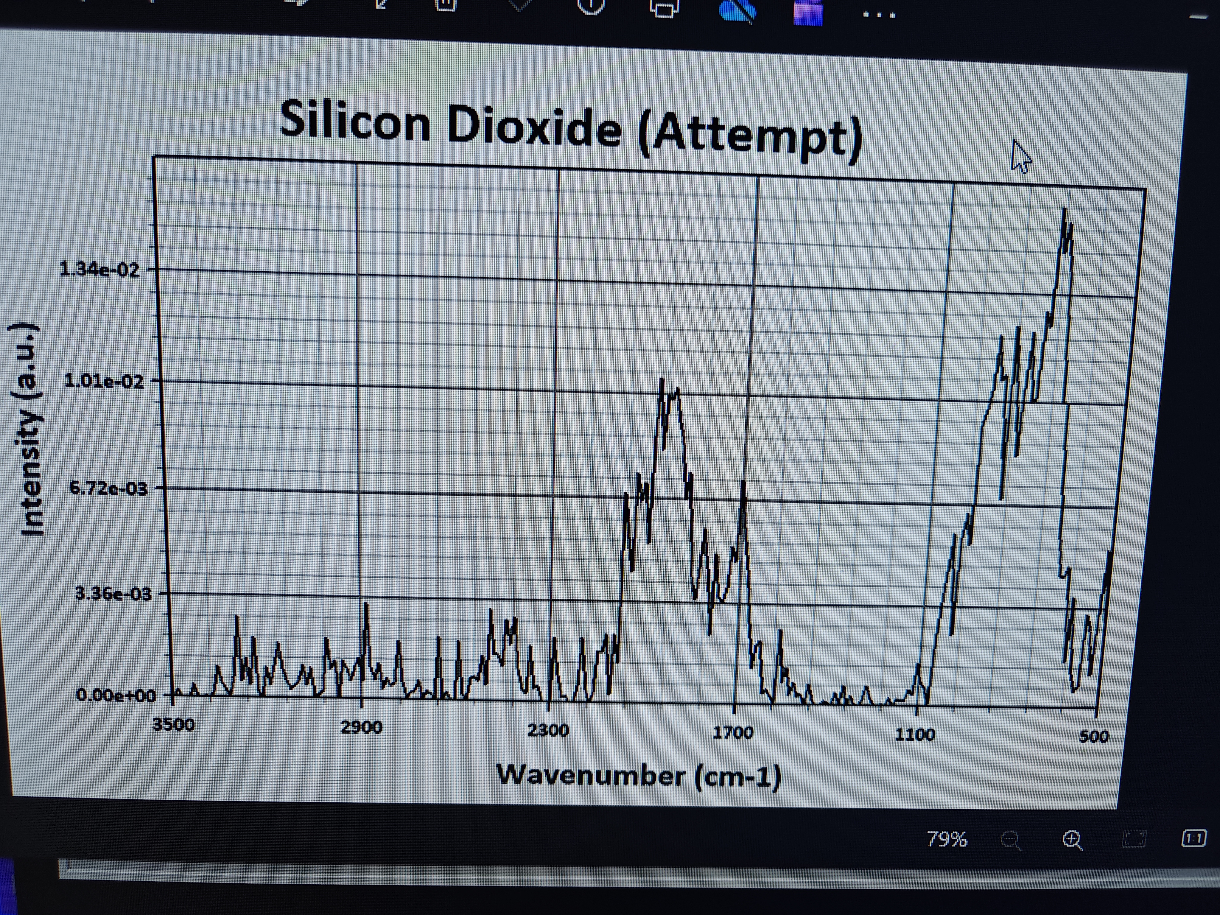

Anyways, I tried doing a similar thing for silicon dioxide powder
But the quality isn't as good and it's shifted by a lot on the x-axis, so I was wondering if I am confused what specifically makes these 2 powders give spectrums that vary in accuracy.

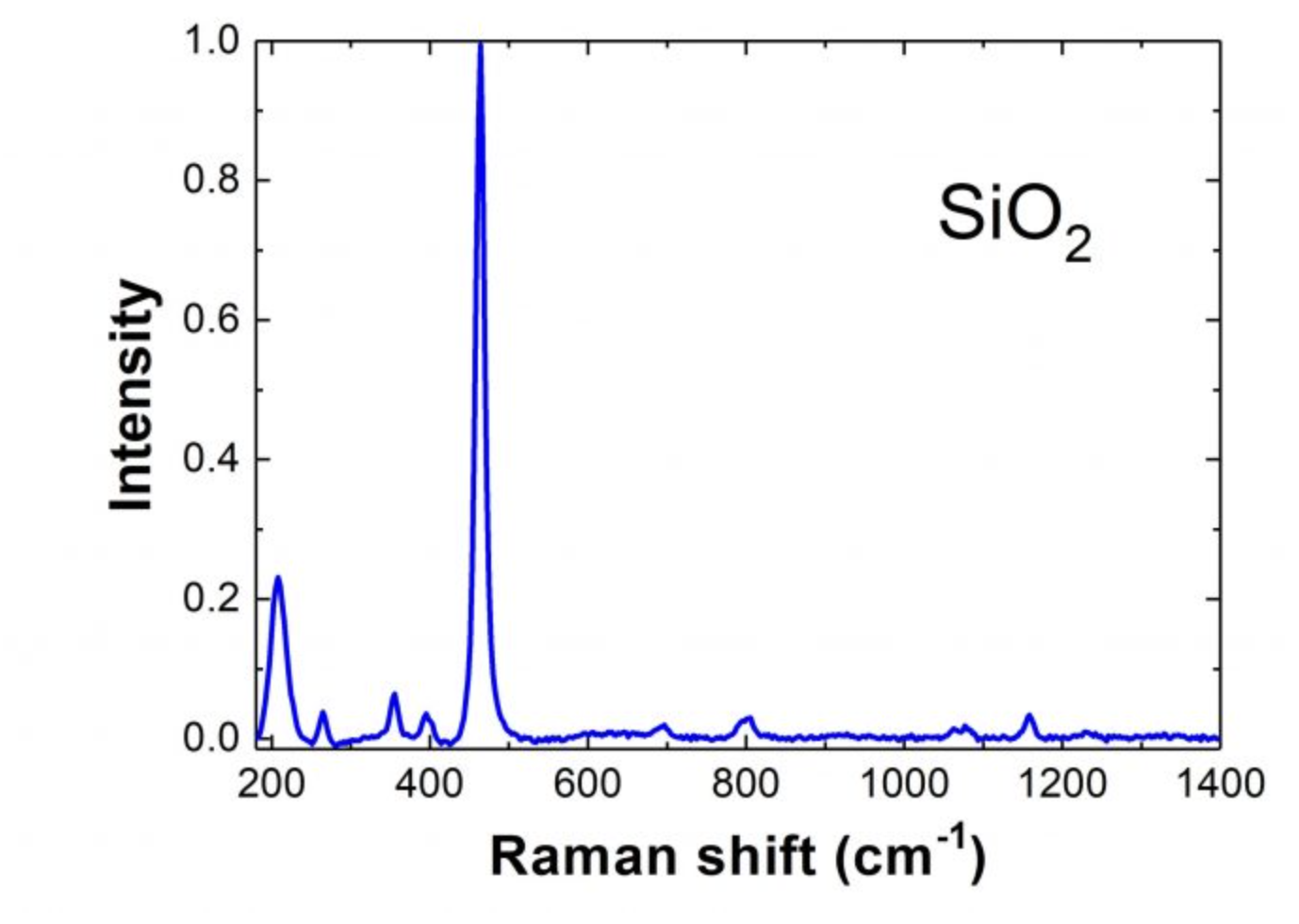

By the way, this the Raman spectrum for silicon dioxide for comparison
Screenshot 2024-11-28 at 2.54.56 PM.png (472.18 KiB) Viewed 394925 times
Re: Solid Powder Cuvette Question
I'm surprised about the low resolution of the paracetamol peaks despite you're using the higher quality laser.
If you take a spectrum of isopropanol do you get a sharp peak? If not it could mean that the laser is not operating at its best operating point (temperature and current)
