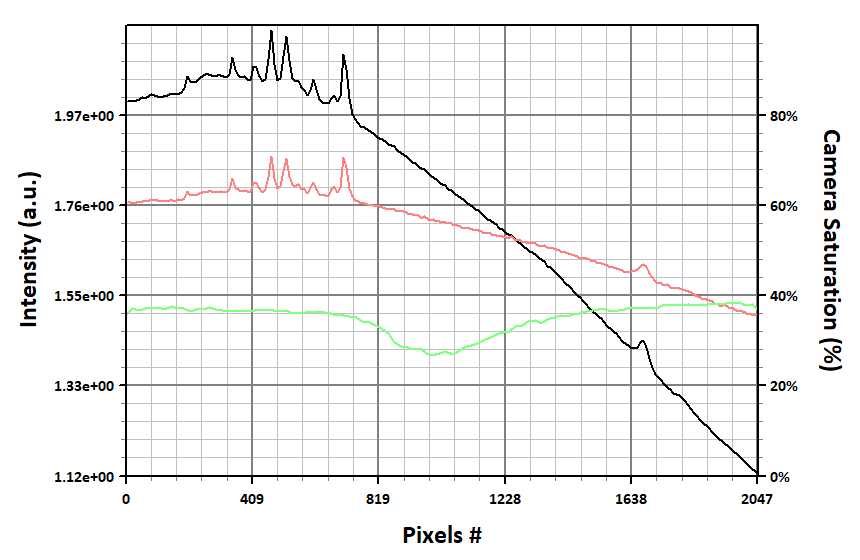

I've attached one of the better spectra of salicylic acid we have been able to get, this is with baseline removal off, exposure set at 1122ms, gain set at 28, and num avg set at 10.
How critical would you say tuning the saturation is to getting an accurate spectra? We have observed that our black spectra line can take the exact same shape while the red and green curves fluctuate between replicates. I ask because our goal is to read a number of different biological samples (mostly microorganisms) and compare their spectra. Do you think tuning the saturation perfectly for each sample will be necessary?
I think those software upgrades sound extremely useful! Is it possible to do pixel binning to further increase signal to noise?
Thanks for all your help
Ben

You don't need to fine tune the exposure for similar samples :) the scale of the black curve also automatically compensate for different exposure time and gain also.
From the raw signal, it looks like you have a lot of offset. This is usually found when you have light leakage into the spectrometer or when your sample exhibit fluorescence. There's little you can do about fluorescence but for light leakage dimming the ambient light is the easiest option.
