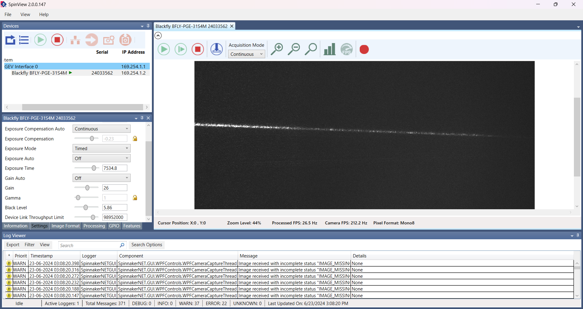

I am having trouble calibrating the Raman. For reference, I'm on step 9 (https://www.open-raman.org/build/starte ... /assembly/), and I'm not getting a similar quality of image as shown in the Youtube tutorial. This is the image I got:

The image you get looks like the spectrum you'd get from a coherent source (which seems to be the case since you're using a fiber locator on the photo). I'm just surprised by how broadband the spectrum is for such source. For step9 you should use a neon spectral lamp instead.
The quality of the image you observe is directly linked to speckle noise which arise from coherent source. If the fiber is a multimode one, you can try shaking the fiber rapidly. If the integration time is not too short you should observe a much cleaner image (averaging of many speckle grains). If the fiber is single mode (which is a possibility when I see the thickness of the line), you need to couple to a multimode first.

Quick question... is your slit horizontal instead of vertical by any chance? That would explain why it's so broad

I didn't check if the slit was horizontal or vertical - I was rotating it until I saw that the laser light passed through. It might be positioned horizontally, so do you know how I can get the laser light to pass through if I turn the slit to be vertical?
Lastly, when you say the image is broad, do you mean that the line is super long (not based on its thickness)?

I presume you're simply imaging the slit out of the camera active area. Try rotating the grating when the slit is vertical. You should find the signal then.
