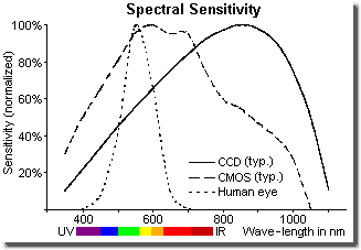

A new ccd spectrometer. You can hunt around on alibaba express for a used or cheap old one and make sure it's sensitive in the new output range.
3-Spectral-sensitivity-graph-of-CCD-sensor-CMOS-sensor-and-human-eye-3-Width-is-5mm.png
3-Spectral-sensitivity-graph-of-CCD-sensor-CMOS-sensor-and-human-eye-3-Width-is-5mm.png (4.05 KiB) Viewed 156987 times
