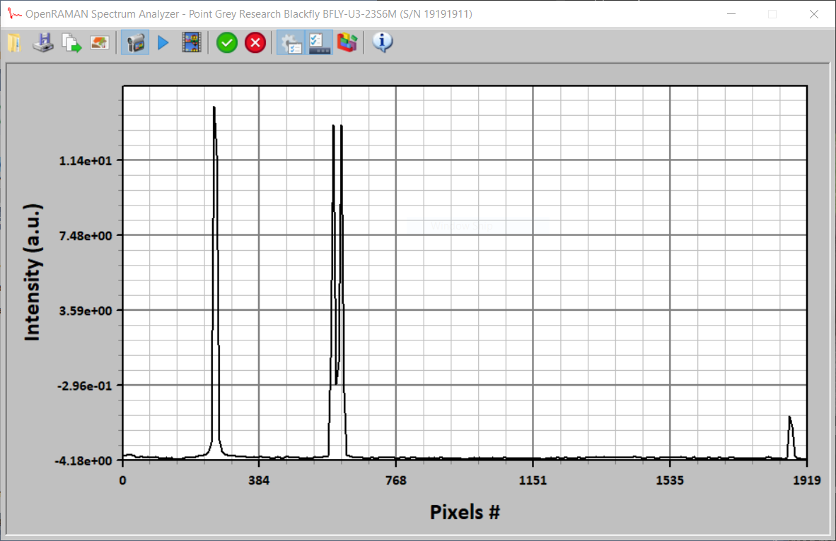

Hi, I am trying to calibrate the spectrometer but I am running in some trouble. I have the HG-2 calibration lamp from Ocean Insight. But when I try and calibrate the spectrum received only shows limited spectral lines. Is there any possibility to manually set the wavelength of specific spikes? The software does not handle the big gap between the spikes.

Up to now I have tested only with NE-2 lamp. Would you be kind enough to send a screenshot on what does the HG-2 lamp spectrum looks like ?

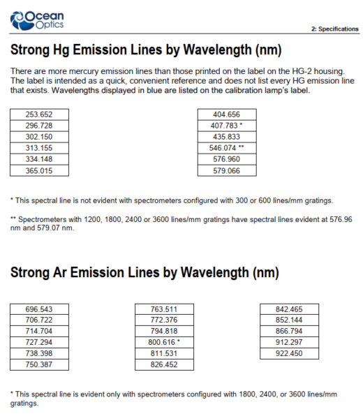

Attached should be the emission lines from the light source, yet the other image is what is measured on the sensor. Through some analysis, the leftmost emission line should be the one at 546.074nm as this can be filtered away by the dichroic lens. Is there any way to manually set the emission lines on dedicated emission lines?

It's indeed not ideal but you should be able to perform a linear model at least.
What happens when you do that ? Can you send a screenshot ?
