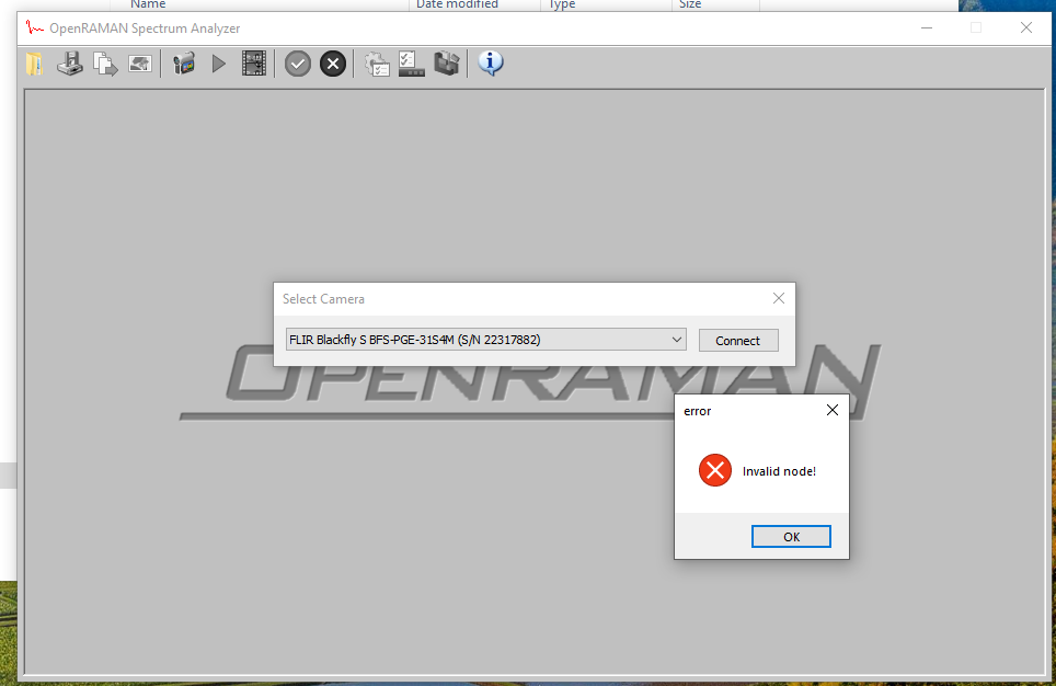

Have flir bfs-pge-31s4m camera which is recognised in Spinnacker
Spectrum analyser sees the camera but during connect have error 'Invalid node'
Also the same behaviour in successful fresh x64 Spectrum Analyser build in VS2022

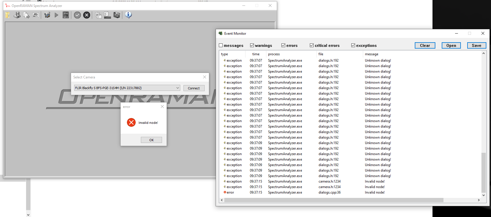

Here is the screenshot with attached zipped err file

Re: invalid node error during connect to camera in Spectrum Analyser
I confirm that it is coming from a portion of the code that should never trigger (fail safe). For some reason, one of the mandatory parameter of the camera (exposure, gain, ROI...) cannot be accessed.

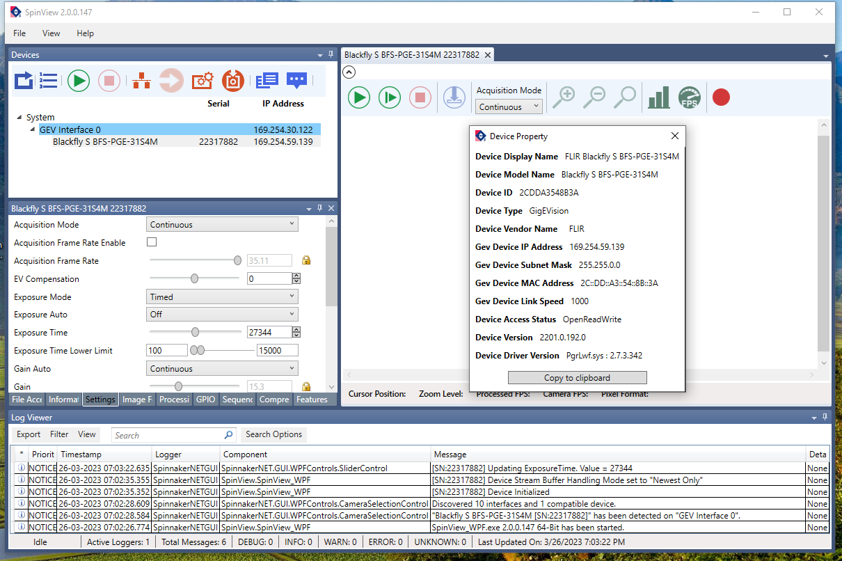

- Close all softwares (Spectrum Analyzer, SpinView etc.)
- Change your adapter IP to 192.168.100.1 with subnet mask 255.255.255.0
- Start SpinView and update camera IP; check that you can access camera frames (start acquisition)
- Close SpinView
- Start SpectrumAnalyzer and try if it connects
If it still not work, could you tell me if you know how to use the debugger in Visual Studio ? If not we'll do a bit differently (I'll send you a modified dll that display messages)

unfortunately it shows the same error despite IP address of the camera in correct DHCP range.

Long story short, in the camera dll project you will find plenty of lines that initialize the nodes such as FloatProperty followed by strings like "Analog", "Gain". These are the addresses of the nodes inside the camera and should match the names in spinview.
The tricky part is that you should not be looking at the node label in SpinView ("AnalogGain") but click (right-click?) on it to display a full dialog with more information. There you will find the full node access path -- it's how I did it in the first place.
