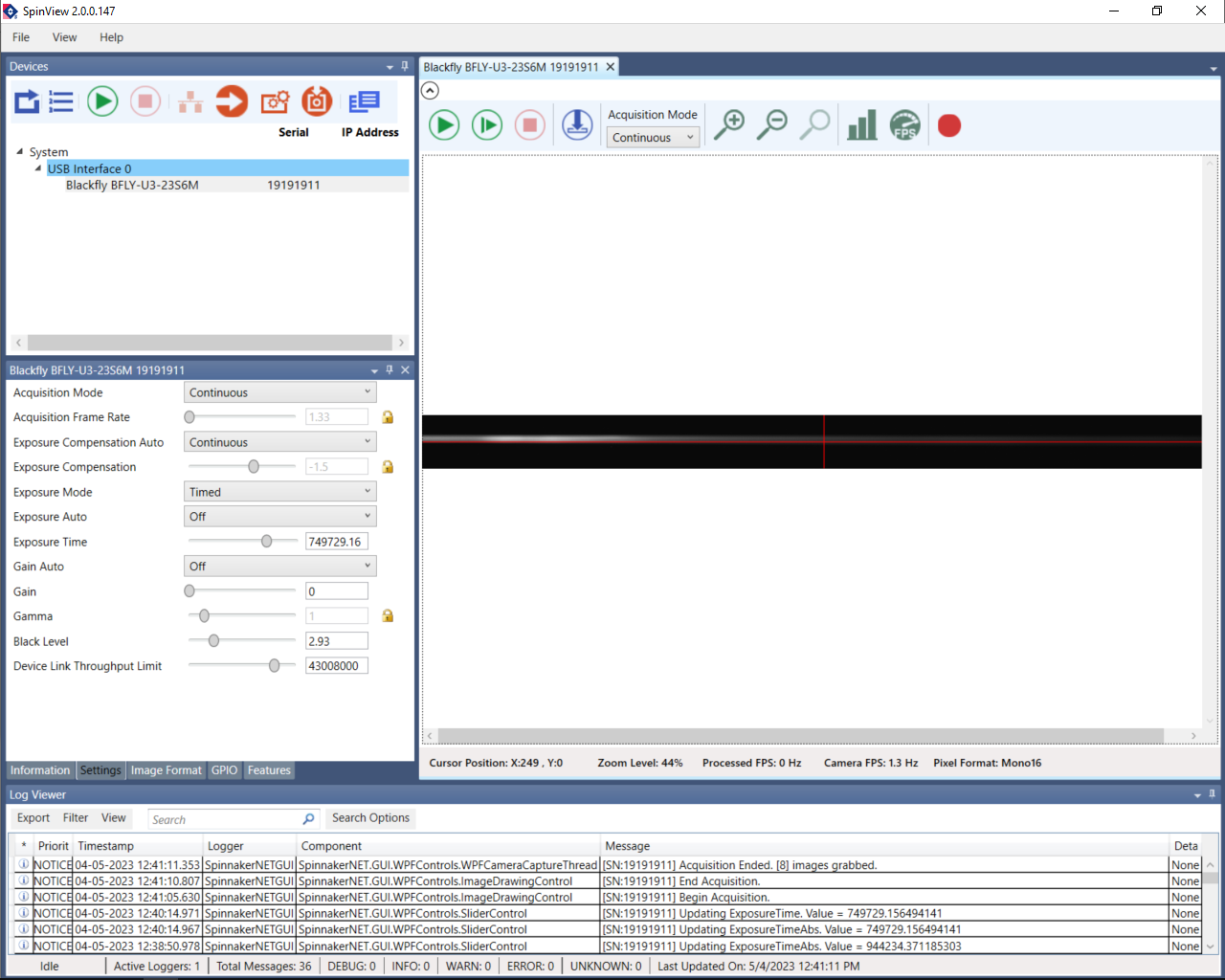

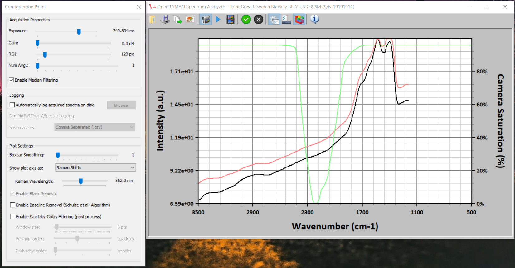

Here is a new measurement of acetone and the results on both Spinview and spectrum analyzer

It still looks a lot like fluorescence. The image is very clean in SpinView and your beam is well centered so optically speaking I don't see anything wrong.
Did you use the same test tube as for the previous sample? Fluorescent contamination tend to stick very well to glass.

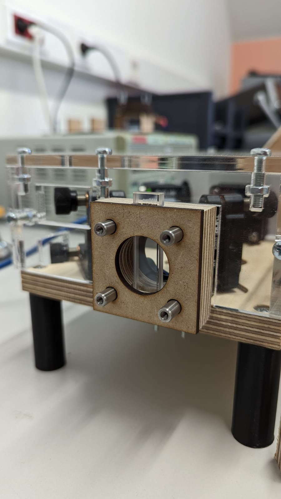

And could there be any problem with an open cuvet holder as shown below?
Could there be any explanation as to why the quarts glass is giving this result?
- CuvetHolder.jpg (96.48 KiB) Viewed 67784 times

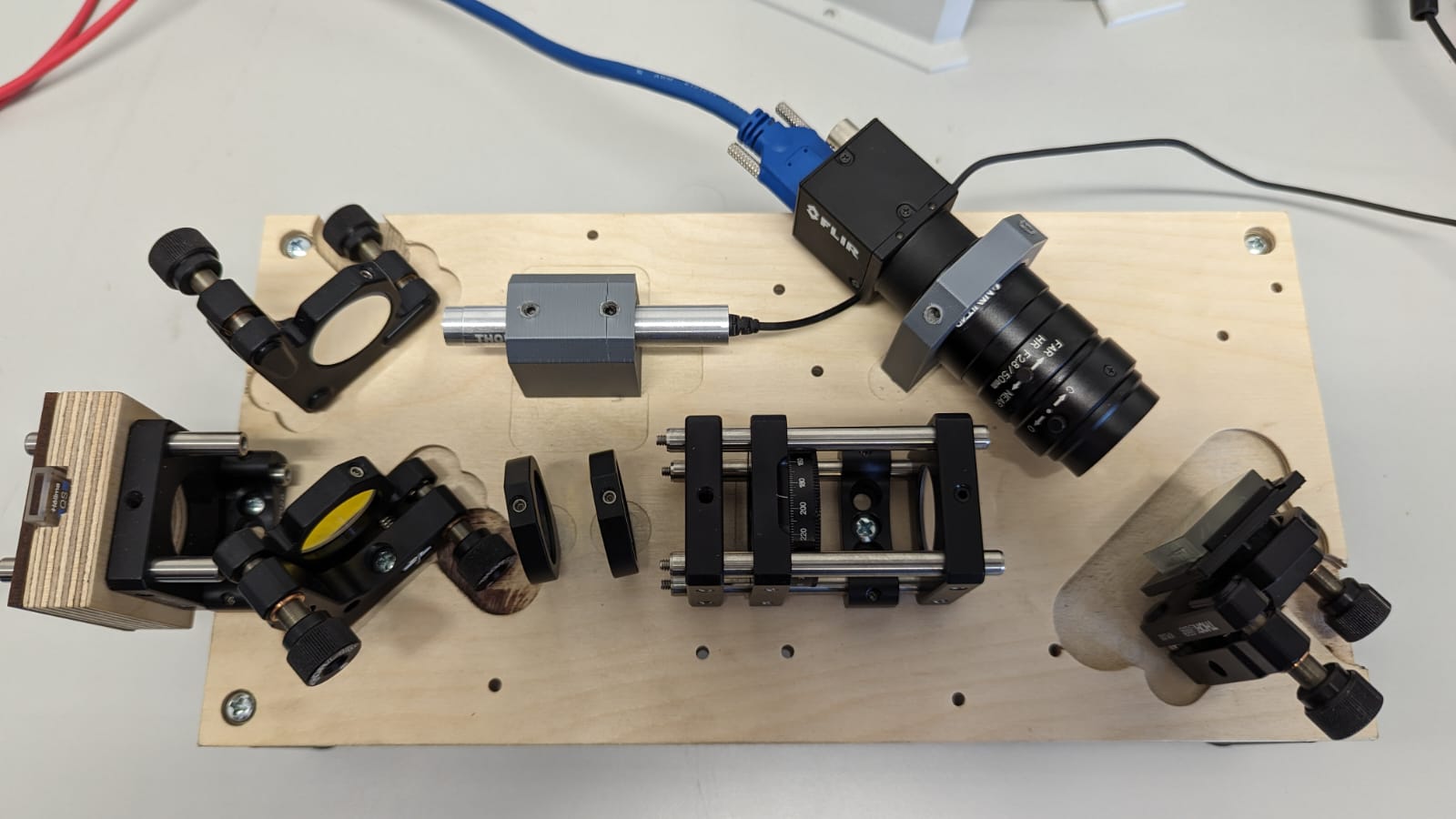

Could you take an image from above the setup? Also, could you confirm that you are using a lens to focus the beam?
What happened to me is that I contaminated my cuvette with a fluorescent compound and after that it was dead, impossible to remove the adsorbed contamination :-/ with the test tube when it happens I just replace the tube which cost only ~0.1€ or so.

The setup is as the instructions said, just the holder for the cuvet is different as I had a different cuvet. There is no light-covering enclosure around the cuvet. The source light is never reflected back towards the lenses, it just goes through the sample
- SpectroSetup.jpg (104.92 KiB) Viewed 67780 times

On the picture I don't see any focusing lens in front of the sample. Could you confirm if I spotted right?
You'll need one or you won't get any signal for sure. I used a 19mm achromat but a microscopy objective can do the job as well.

I was not aware that another lens in front of the sample was needed. Could you point me to where this is mentioned?
Re: Calibration
They are in the cuvette assemblies themselves; the cuvette for test tubes even has a cylindrical lens to get a tighter spot size : https://www.thepulsar.be/article/raman-cuvette-upgrade/
The overall system is sketched here with a brief explanation: https://www.thepulsar.be/article/the-mo ... -openraman
