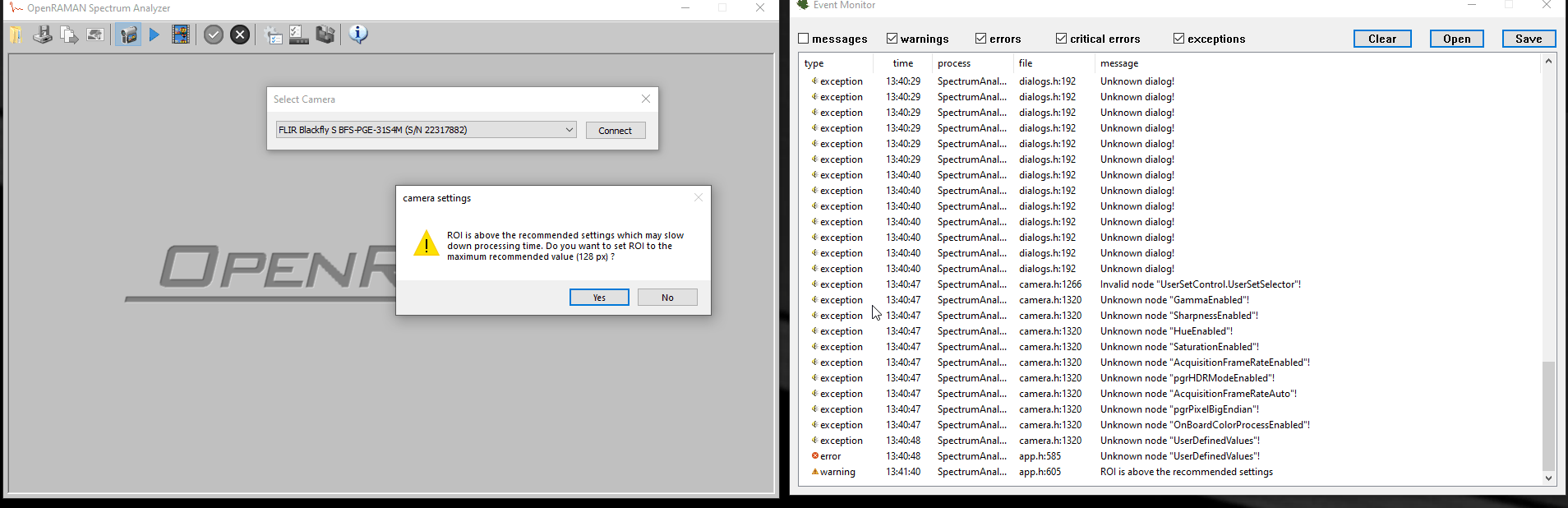

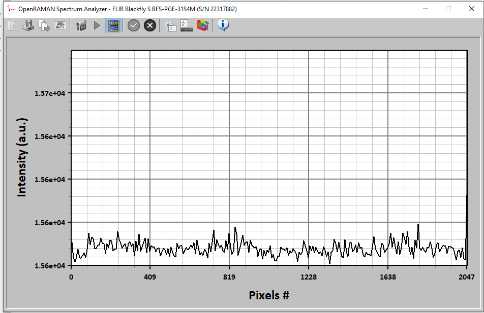

Thanks a LOT ! its working now, only complains about dead nodes and ROI above recommended settings ( see attached files with list of evemon silent nodes). Is there a workaround to save calibration parameters?

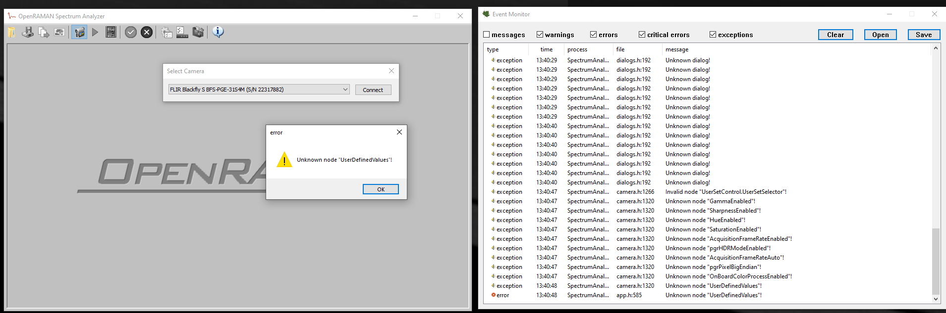

invalid node error during connect to camera in Spectrum Analyser

- live.png (17.84 KiB) Viewed 293999 times
- roi.png (52.95 KiB) Viewed 293999 times
- nodes1.png (53.05 KiB) Viewed 293999 times

Not at the moment unfortunately. They also changed the way to access camera data and that's why you are getting the error with the UserDefinedValues thing.

Jack which folder did you put the patch into? It needs to go bin64 not bin. You'll still get a user defined values error but you can click through it and it will still work
