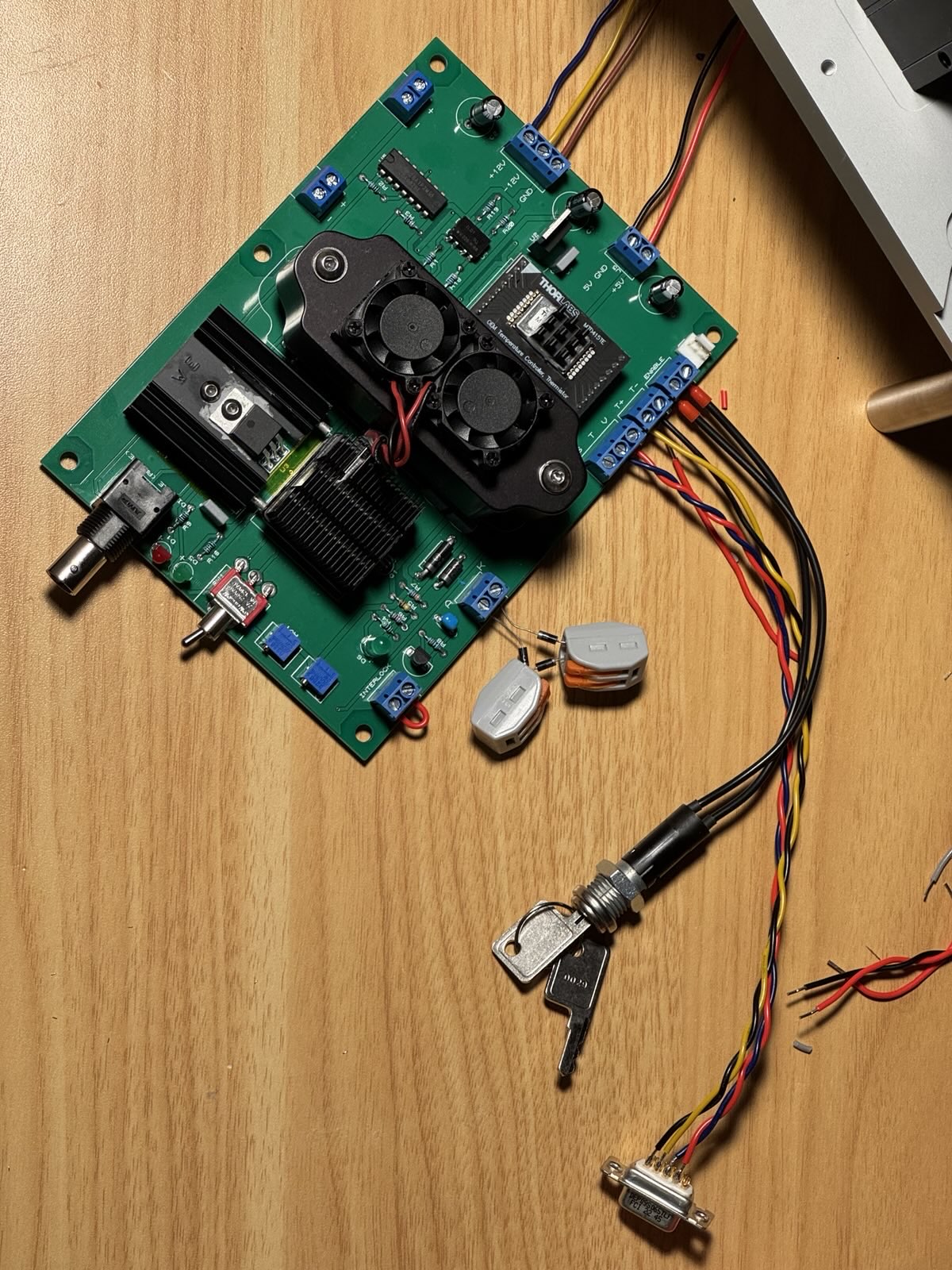

  • The custom LC/TEC driver board:
    • Several components on the BOM are no longer available on Digikey and required alternatives:
      • L7808CV is obselete, use UA7808CKCS instead (parametric match)
      • L7908CV-DG is obselete, use UA7908CKCSE3 instead (https://www.mouser.ca/ProductDetail/595-UA7908CKCSE3) (parametric match)
      • ILD1 is obselete, but is still in stock on Mouser. I probably could've found a parametric match for this, but since it was available on Mouser and I had to make a Mouser order anyways for the UA7908CKCSE3, I just got it from Mouser.
      • RNMF14FTC33K doesn't exist, I think it's meant to be the RNMF14FTC33K0.
      • FEX40-40-21/T710/M2 (fan) was not necessary in my case due to using an aluminum baseplate (the entire baseplate acts as a heatsink and was tested for over an hour without overheating), but definitely still needed if using the SLS Nylon 3D printed base plate. A helpful note if you use this fan: the pinout uses the common convention of red for VDD, black for GND, and yellow for the tachometer output. I found this blog post helpful in figuring out what the instructions meant about active cooling: https://www.thepulsar.be/article/thorla ... er-review/ (stick the fan/heatsink on top of the LDM21, then connect it to FAN1 on the driver board). The cable is likely not long enough, so you will likely need to extend it by splicing a longer wire in.
    • FAN2-FAN4 on the BOM specify the WM2700-MD 2-pin connector, but the WM2700-MD doesn't actually fit the footprints FAN2 and FAN3, though FAN4 is correct. from the photos, FAN2 and FAN3 seem to use the ED2609-ND 2-pin screw terminal instead. I recommend buying 2 extra ED2609-ND to account for this, replacing 2 of the WM2700-MD connectors.
    • C1-C3 are all supposed to be P15348CT-ND, but the BOM entry for the P15348CT-ND doesn't mention C1-C3 as the reference designators
    • helpful assembly note: FAN4's latch should face toward the "FAN4" label on the PCB (perhaps I'll take a crack at adding PCB markings for this!)
    • I managed to snag the LD3000 for less than half price from eBay, this listing was the one I used: https://www.ebay.ca/itm/315865615398
    • For north americans (I'm located in Canada), replace the AC power cable "Q960-ND" on the BOM with a north american equivalent: https://www.mouser.ca/ProductDetail/Qua ... Guvg%3D%3D
    • It's generally not recommended to use stranded wires in screw terminals (the strands compress and fail to maintain contact pressure, and eventually tend to slip out), so I recommend crimping on ferrules (https://www.arrow.com/en/research-and-e ... u-use-them) for any stranded-core wires that connect to the laser driver board and the power supply. This might be important for the power cable, which is stranded core and carries full line voltage.
    • Since the TN0702 MOSFET only dissipates around 300mW in operation, it's probably fine to replace the #2020-20/1 custom heat sink block with an off-the-shelf one like the Aavid 294-1155-ND, though I didn't try that for this build.

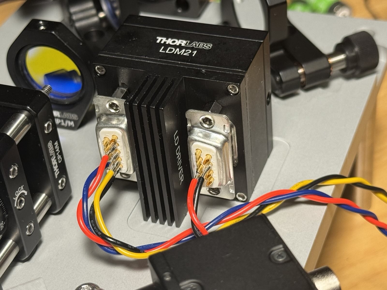

    • the #2 bolts are not needed, since they're for the LDM21 laser diode mount, but the LDM21 comes with #2 bolts already

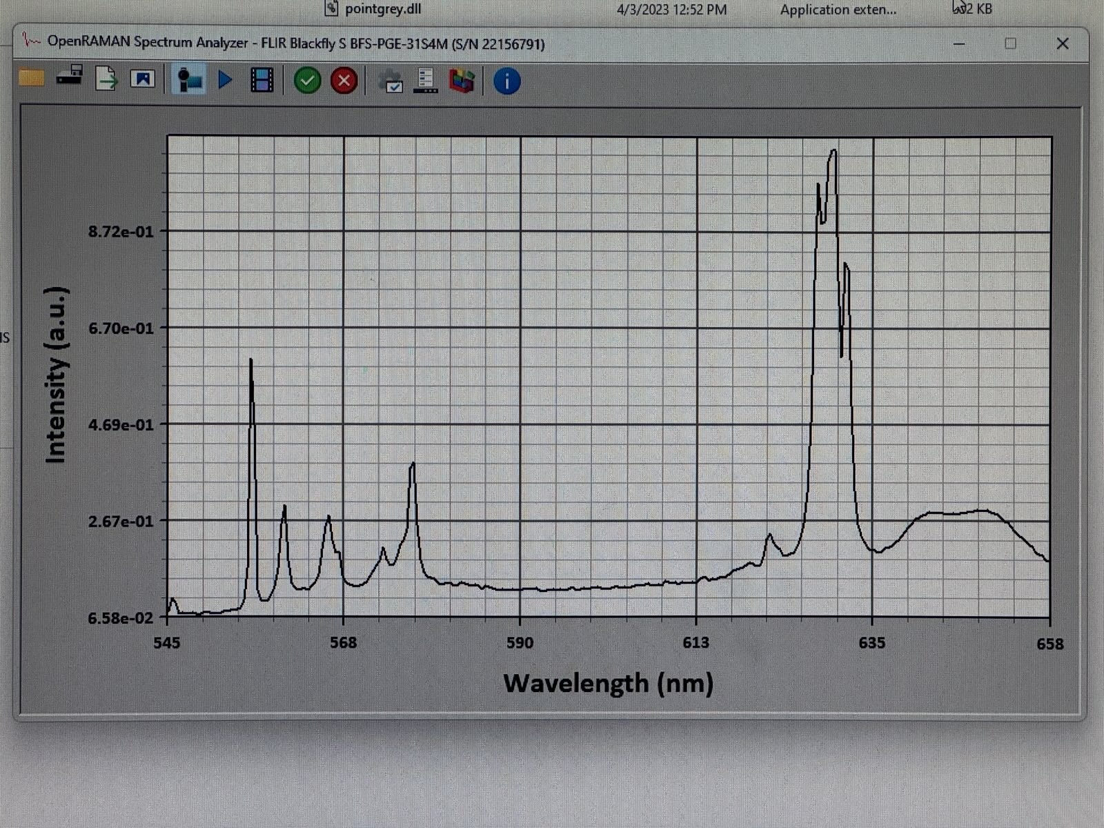

    • When using a fluorescent lamp in step 9, the instructions are slightly outdated - you can't rotate the diffraction grating via the KGM40, you instead have to loosen the #2020-15 grating holder and then rotate it and re-tighten the set screw.
    • Helpful tip: In SpinView, the camera with factory settings will show the spectrum with shorter wavelengths on the left and longer wavelengths on the right. Once you run SpectrumAnalyzer, this seems to be flipped horizontally, so longer wavelengths are on the left and shorter wavelengths are on the right (in SpinView). This took a while to figure out, but you can tell because when you tilt the 550nm longpass filter away from the straight-on position, it reveals slightly longer wavelengths. You can try viewing the spectrum while tilting the filter back and forth to figure out the spectrum's orientation within the SpinView captured image.
    • Instead of using Excel/Matlab to calibrate the wavenumber scale in step 11, the SpectrumAnalyzer software has a convenient calibration function (which is also mentioned in the assembly Youtube video). The neon spectrum has a great reference image here: https://www.eureca.de/files/spektrum-gl ... ll-neu.png (the neon spectrum image in the instructions is unfortunately not displaying on the open-raman.org website). The key is that the huge leftmost peak should be at 585nm in the result, and the RMS output of the calibration should be around 0.001nm or so (from my experience so far).

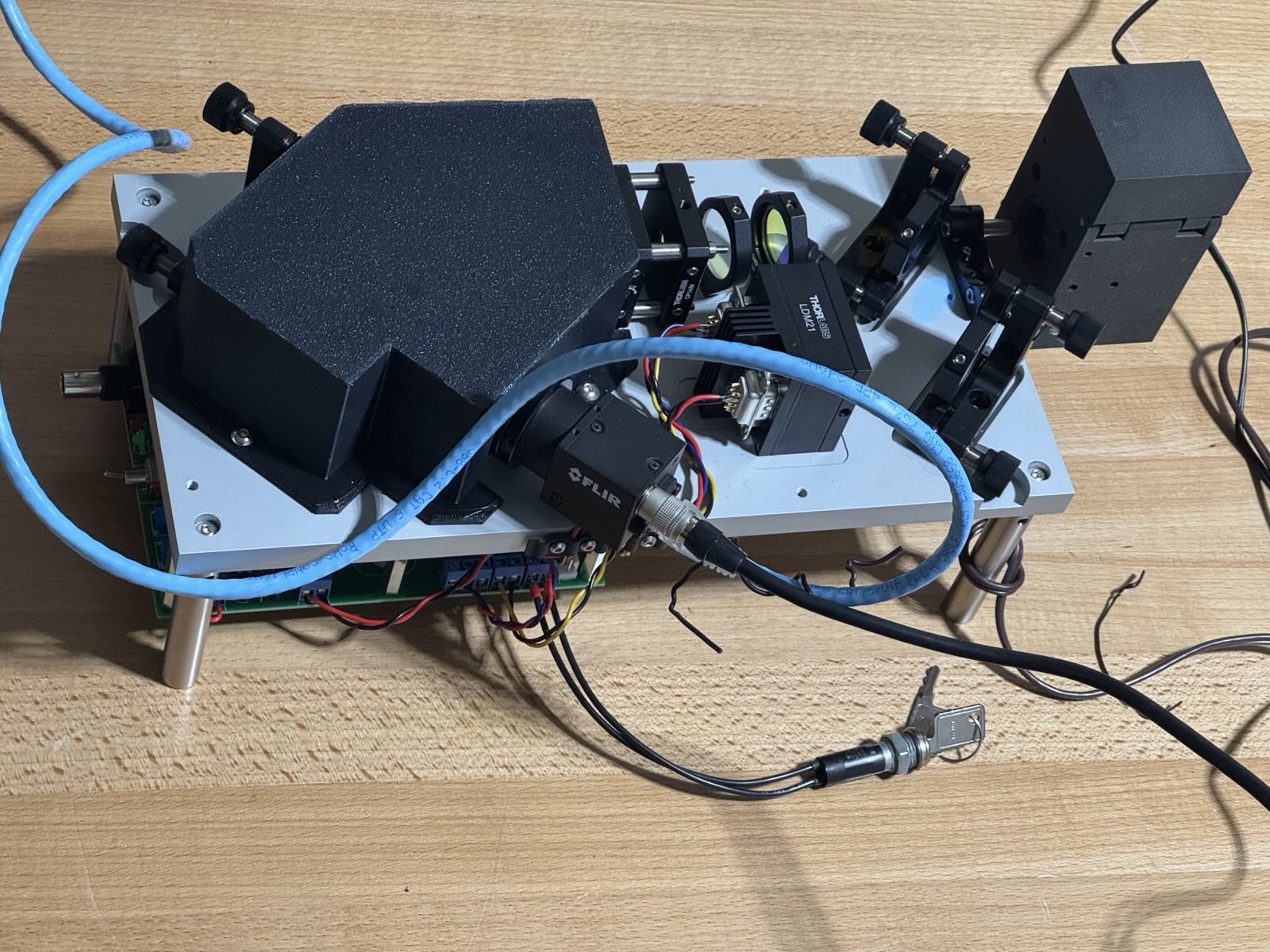

    • For laser safety reasons, I wanted to have the entire unit in a light-tight enclosure. With the liquid or solid cuvette installed, the overall dimensions needs to be around 400x180x180mm, if we want to comfortably reach the laser power switch and the alignment knobs. I ended up finding this one on Amazon that was basically a perfect fit: https://www.amazon.ca/dp/B0F4JY2RGF?ref=fed_asin_title
    • I drilled out some holes for the TR75/M optical posts at the bottom of the enclosure, then mounted the entire spectrometer using those holes. The Ethernet and power cord exits through a single hole that is sealed with a generous amount of opaque tape.

And now for the photos! First, the LD/TEC driver board in the final stages of testing:
The completed spectrometer, right after making a measurement of a sample:
A spectrum for 70% isopropanol (excuse the bad quality - I'm running this inside an airgapped environment!)

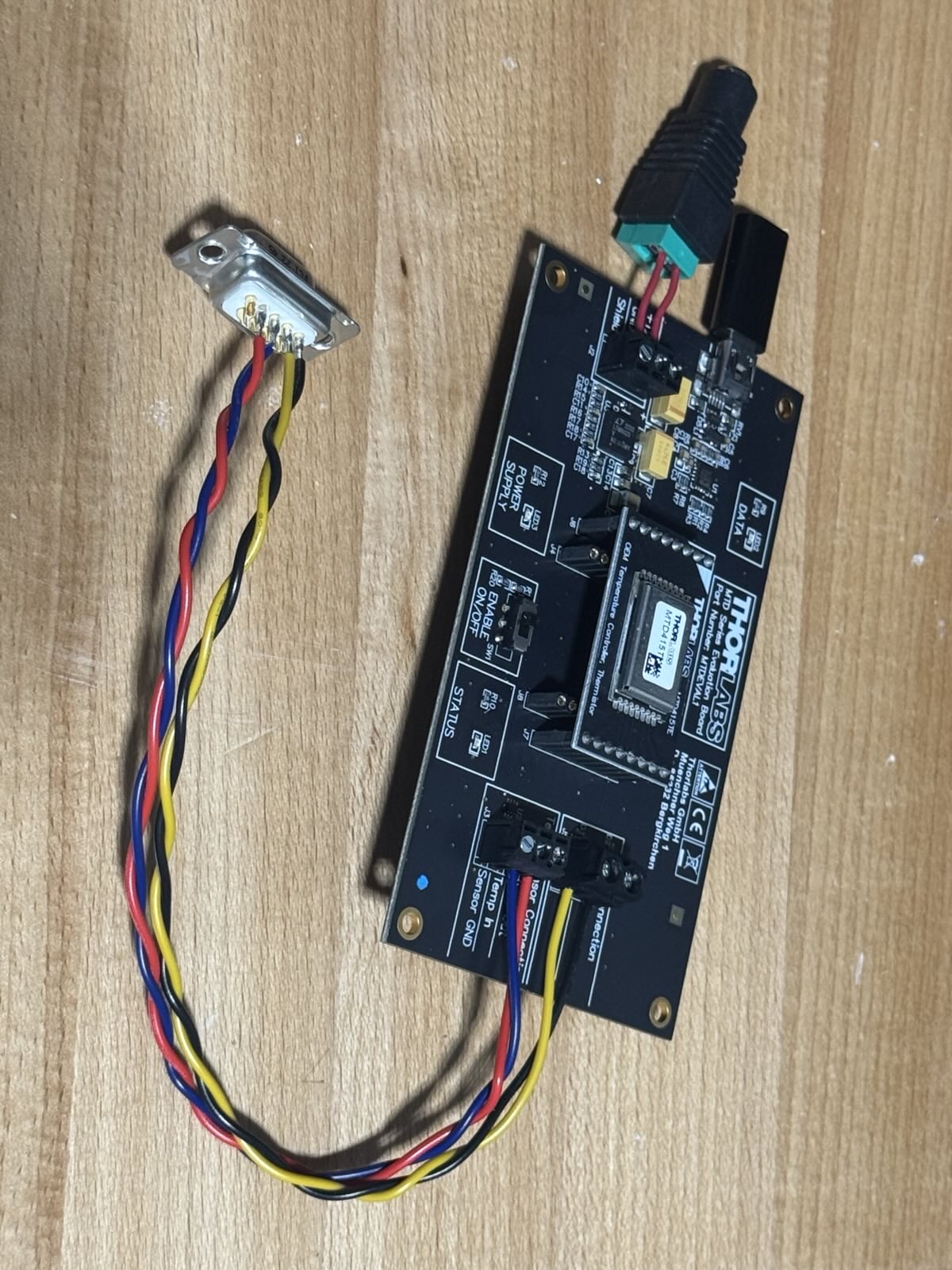

Lastly, there were a few steps where I was unsure how to connect things together, so I'm attaching photos here to help disambiguate. Here's the MTDEVAL1 board, wired up with a barrel jack (for 12V power), a USB-C-to-mini-USB adapter (for interfacing with the computer), and the cables that lead to the "TEC" side of the LDM21. Like the instructions mention, the TEC+ and TEC- leads are the opposite of what you'd expect from the LDM21 pinouts and the MTDEVAL1 board markings.
The other part that took a bit of double-checking was the orientation of all the LDM21 pinouts. Here's a picture of the back of the LDM21, showing exactly which wires go where:
