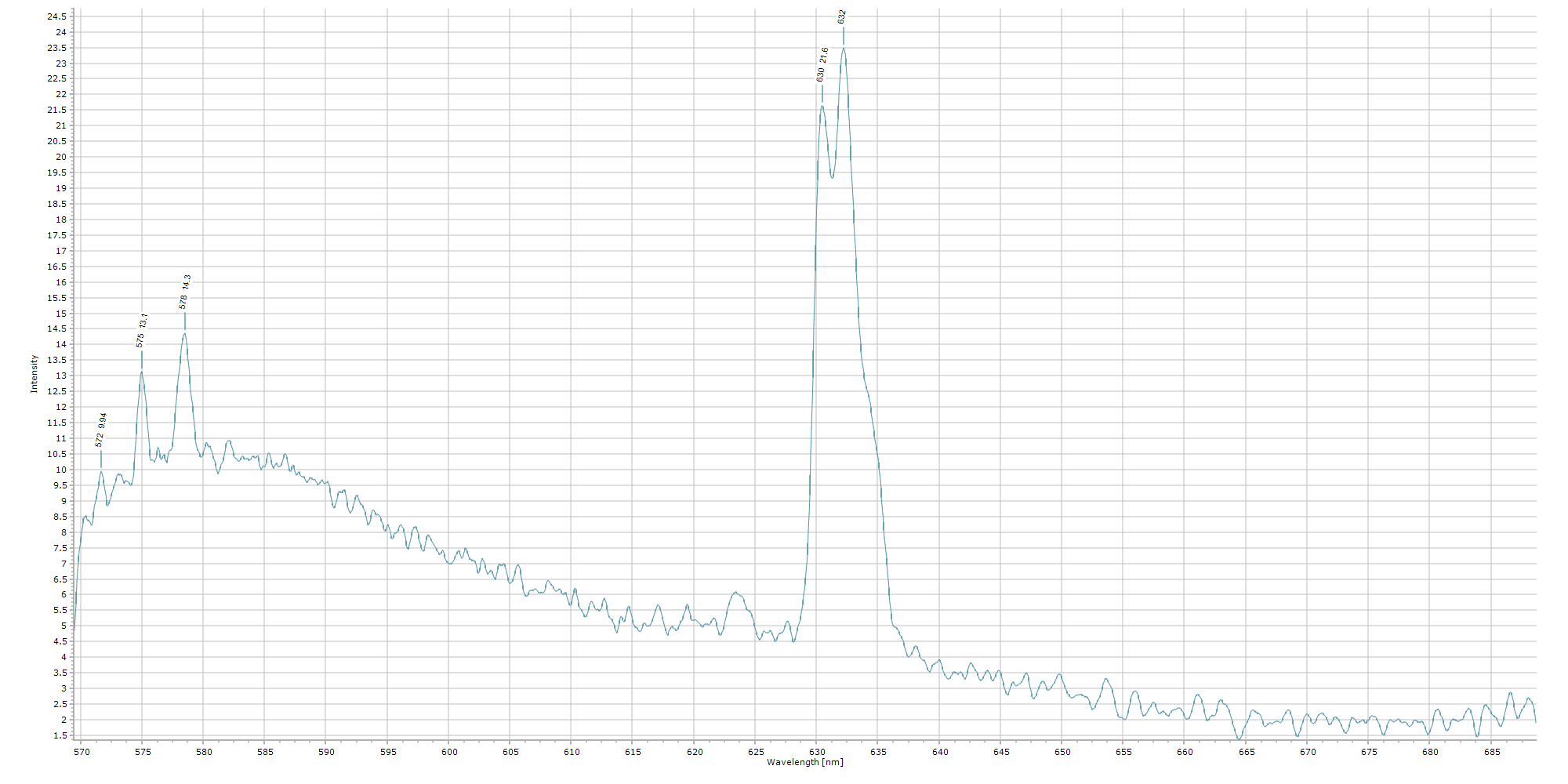

Thank you for your reply. I tried some more times and managed to find the Raman spectrum.
I'll be looking to try to improve the quality of the spectrum (it's weak and quite noisy). I have attached the Raman spectrum of a polyethene sample below (I am using the solid cuvette version). Could you help to advise on how to improve the spectrum?

You can try different substrate to check if it's the polyethylene that has lower signal or if alignment can still be improved. Urea is (relatively) safe to handle, cheap, and has a very clean and intense spectrum for instance.

I don't have urea with me now. I tried using styrofoam but no Raman spectrum was captured. Could it be the styrofoam was too fluffy? I used polyethene crystals. Is it important to use powder or crystals?
Also, if I want to improve the alignment, what would you suggest I adjust?
