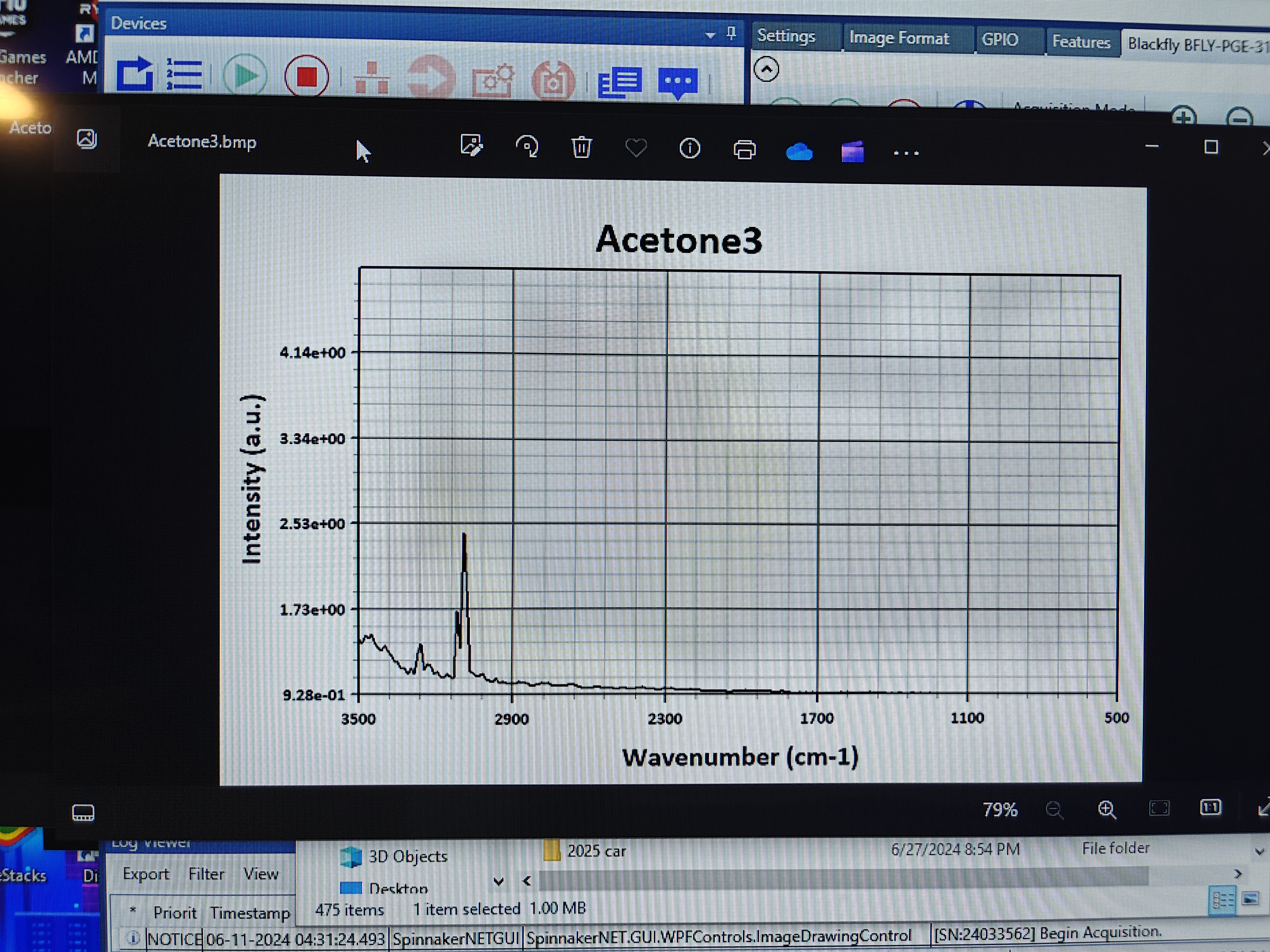

I've been having some issues trying to get an acetone spectrum and would appreciate any feedback.

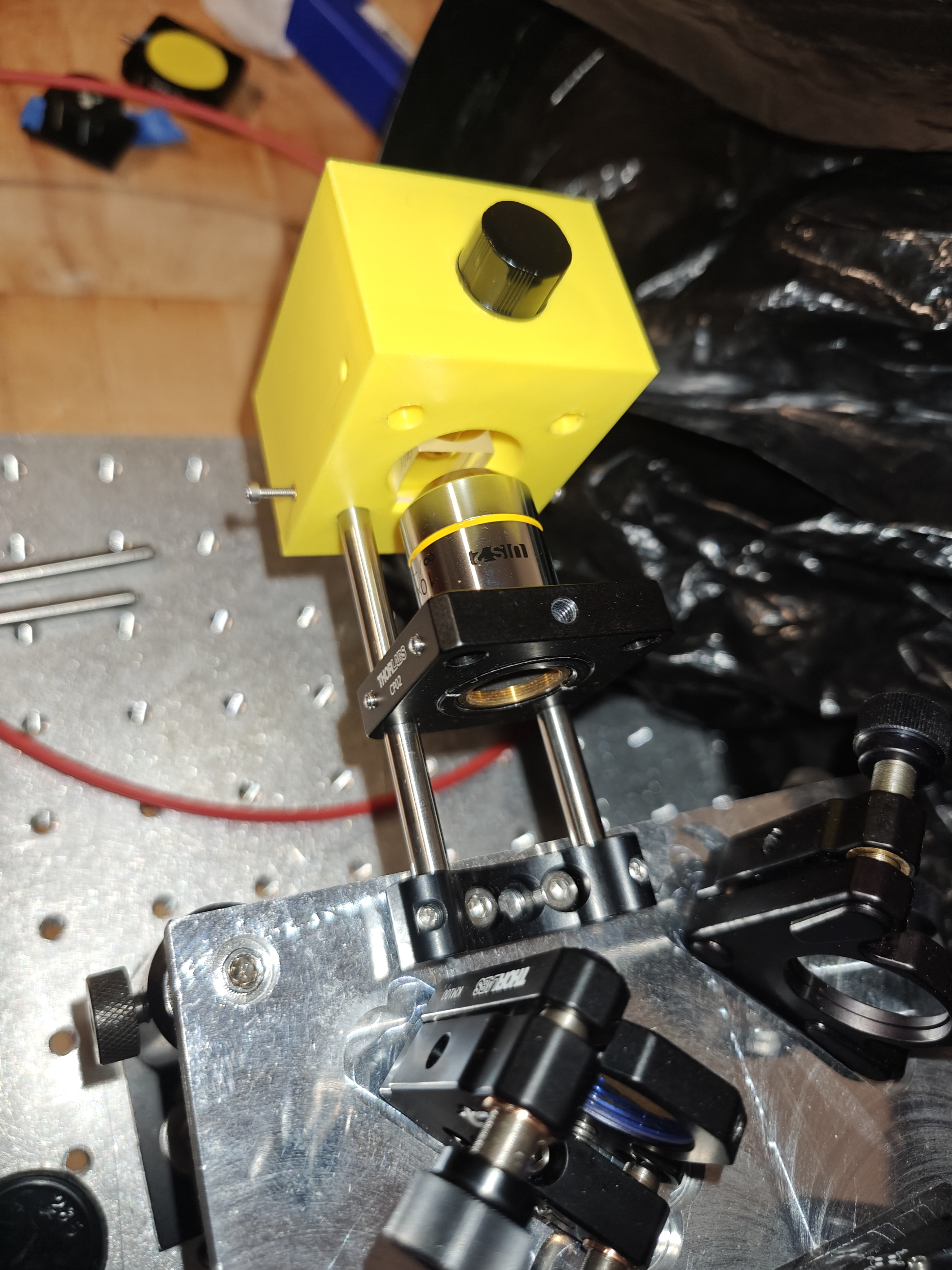

Firstly, I didn't have an achromatic doublet lens on hand and used a microscope objective 10x lens (https://www.edmundoptics.com/p/olympus- ... ive/29222/) instead, so I don't know if that's an issue.
I also used a different glass tube, so I redesigned the cuvette holder to what you see here:

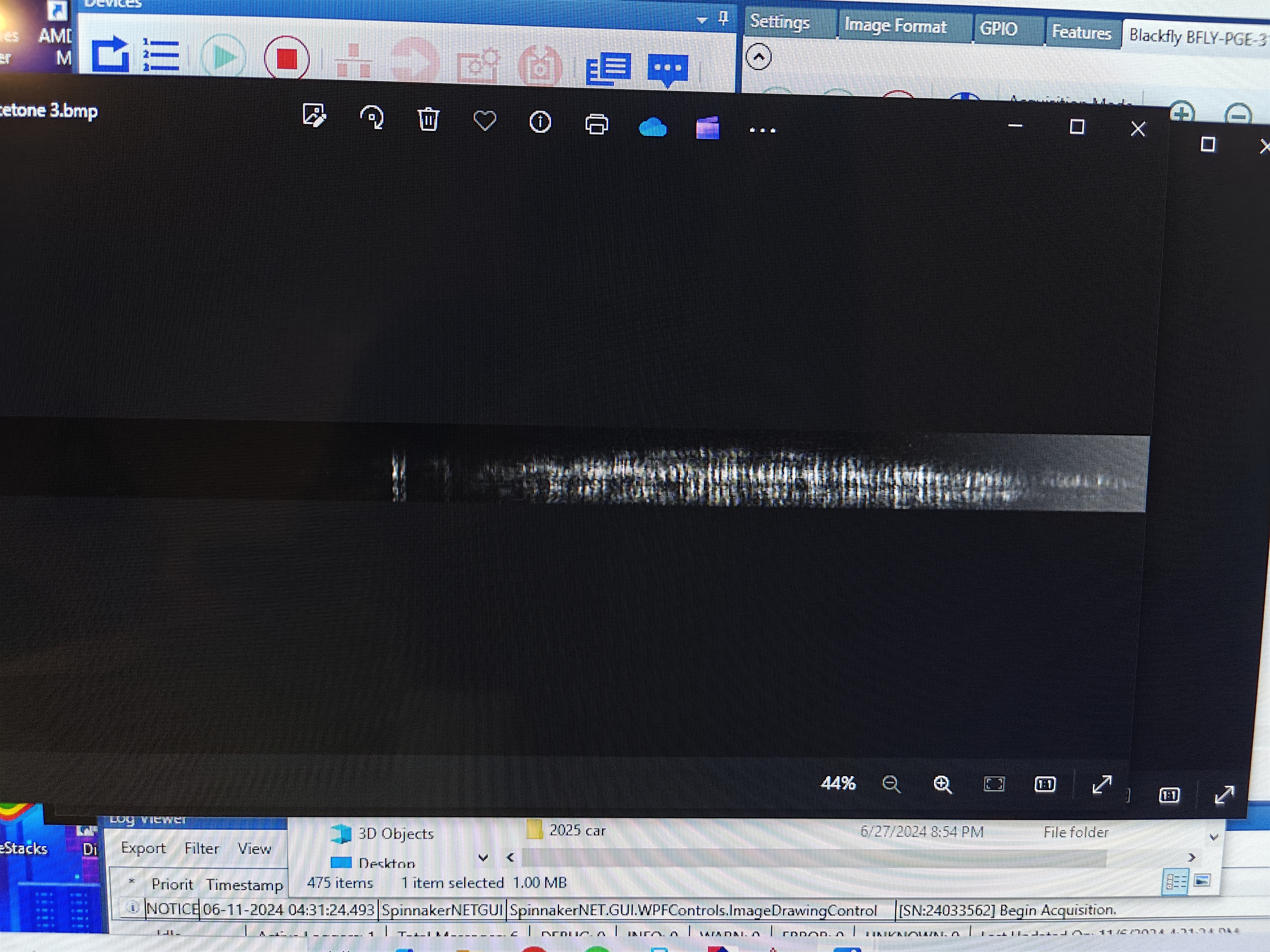

Note, this is the spectrum I got:
This is what I saw through the camera:

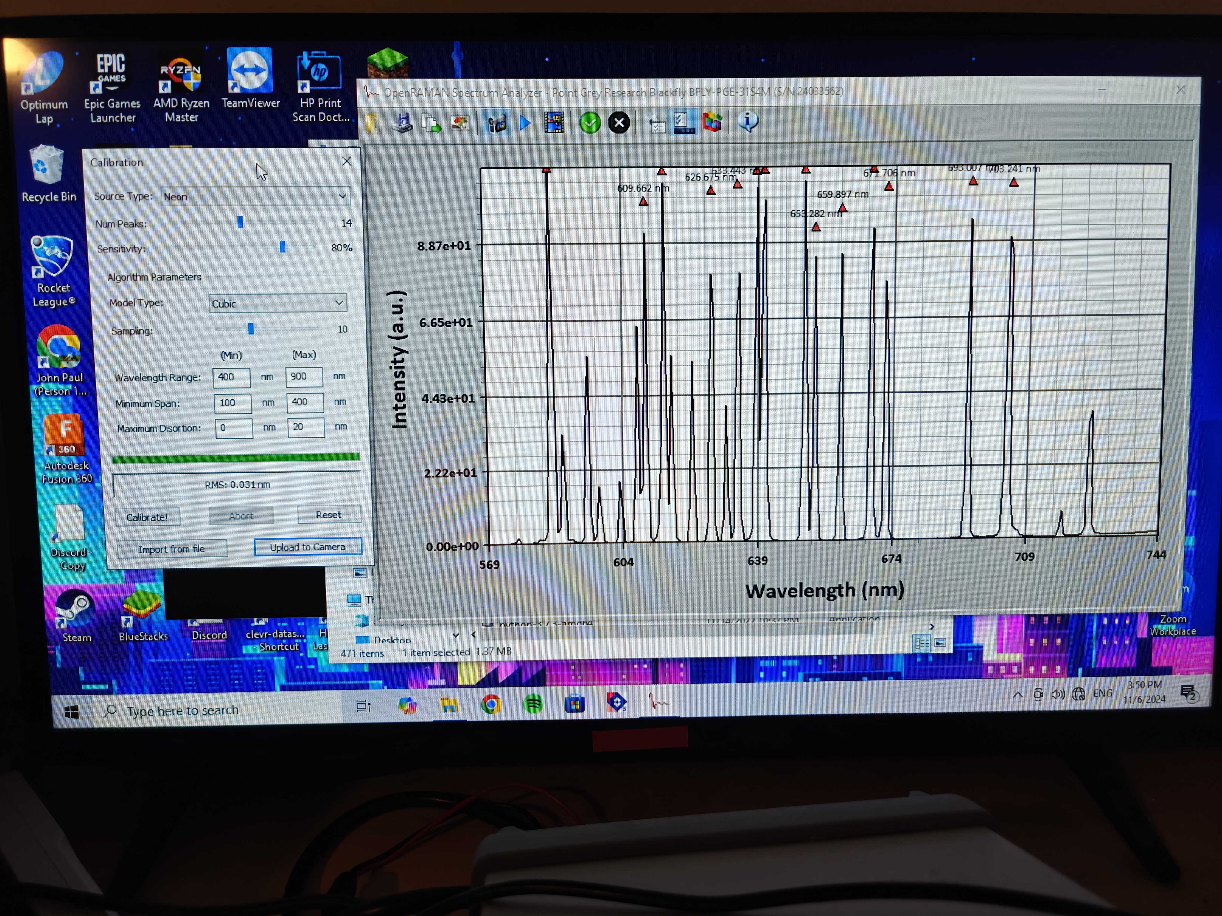

This is what I saw when finished calibrating the neon light
Re: Help With Acetone Spectrum Reading
The calibration looks fishy :-/ I'd say the spectrum needs to be moved to the right.
Just to check, What camera and imaging lens are you using?
Getting the signal can be difficult the first time. Can you try repeating the alignment process using the two frosted disks w/ pinholes?
