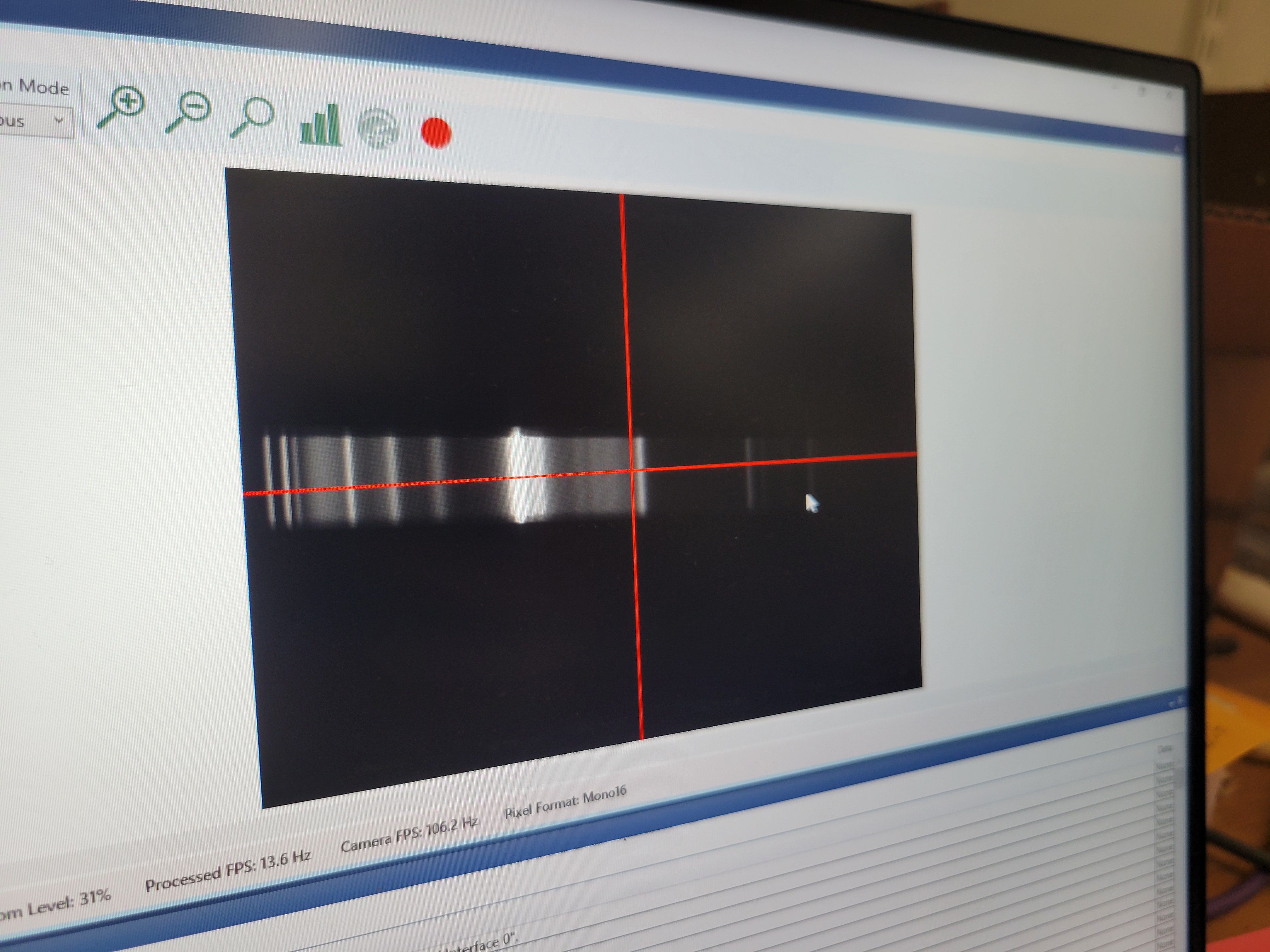

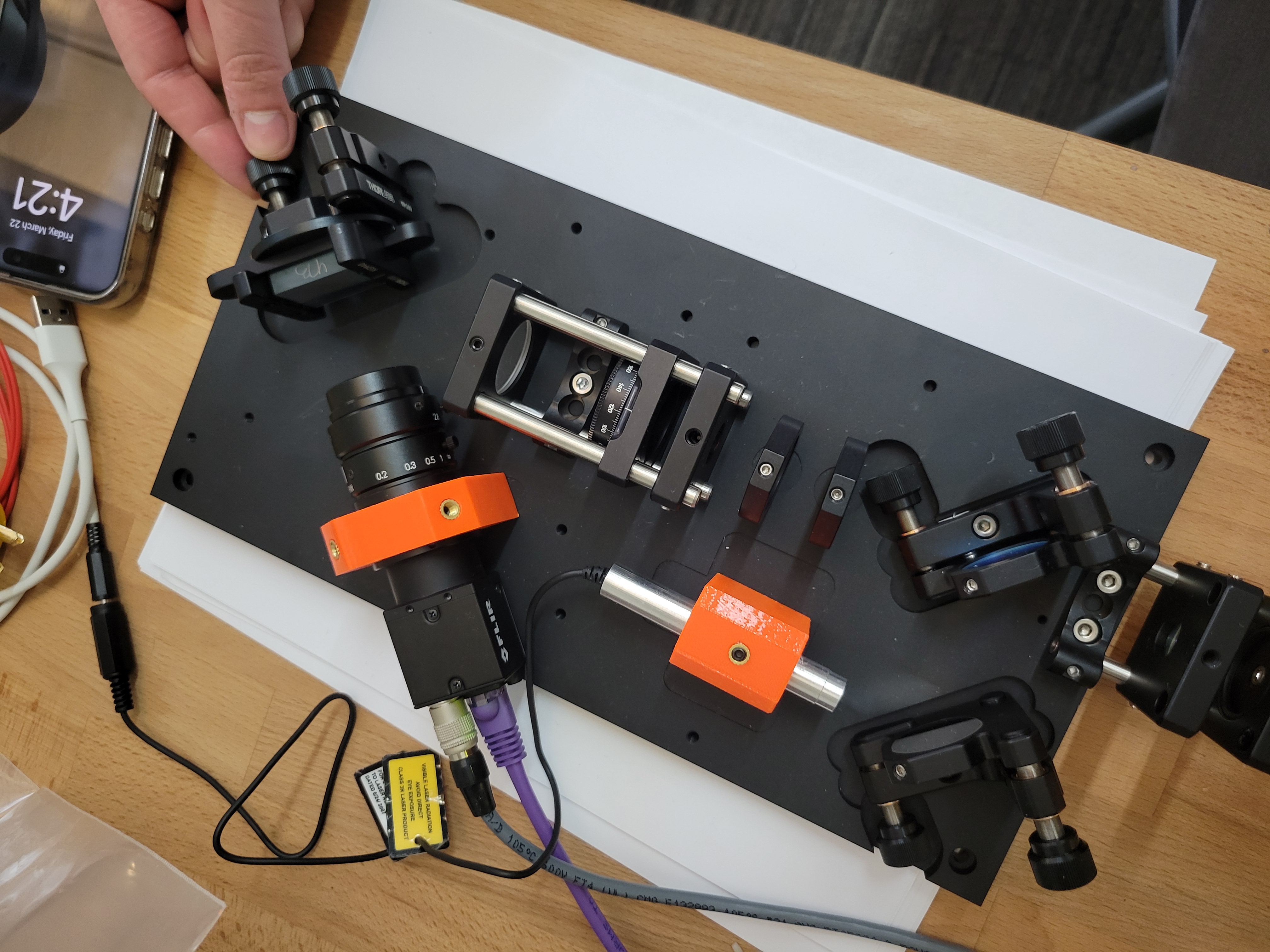

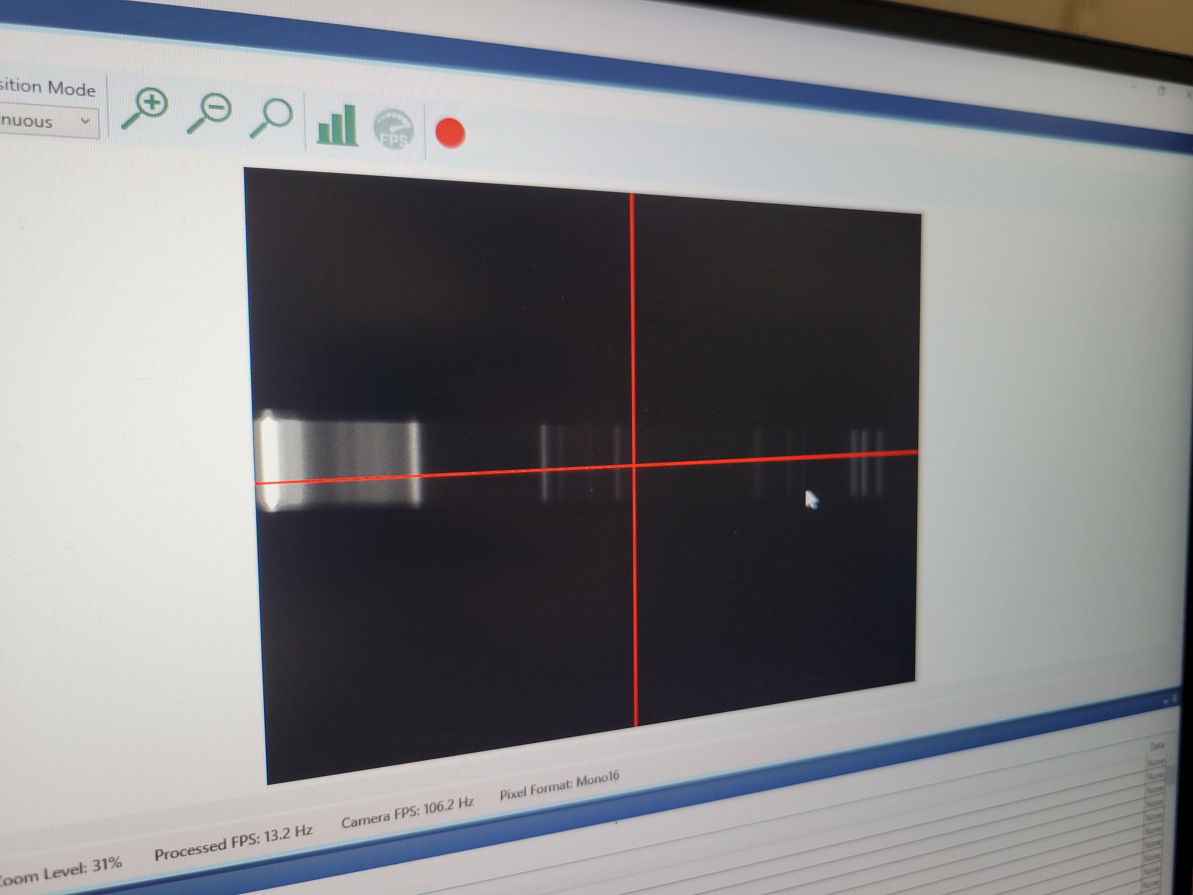

Not seeing the full spectral distribution: Our hypothesis is that the system is actually performing as expected (that is, we are able to see the spectrum that this setup is intended to resolve), and there is additional spectral data that exists, but we are not focusing on it given the specifications of this setup. I've attached 3 images - one is the overview of the setup, the one labeled "far left" is when the grating is adjusted to see the leftmost portion of the spectrum, and "pan right" is after we have adjusted the grating to pan right (you can use the high intensity spectral line as a point of reference). If we were to continue panning right, there would be additional spectral data, but our thought at this point is that it lies outside the specification of this system. Interested to know if you have any thoughts / if you agree with that assessment!

- Far left.jpg (2.84 MiB) Viewed 141460 times
- Pan right.jpg (2.65 MiB) Viewed 141460 times
- 20240322_162127-2.jpg (2.9 MiB) Viewed 141460 times

Generally speaking, the span required for Raman spectroscopy at 532 nm is much smaller than the total spectrum of most calibration sources like neon or even the fluocompact lamp. So it's not an issue if you don't image the complete spectra of these lamps. Here, you'll only need about 110nm to cover the emissions from 500 to 3500 cm-1.
I see that you are using the big grating holder part from thorlabs. I stopped using it because it blocks (vignette) a big portion of the light. You'll find on the website a small custom part to hold the grating with a bit of epoxy glue and that solves this issue.
