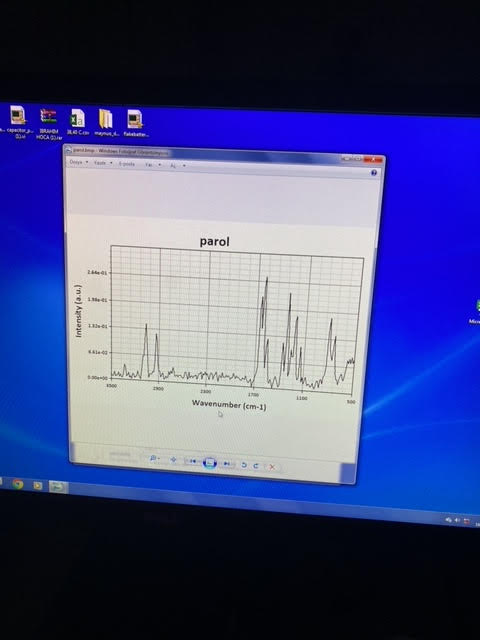

Then I aligned for the solid quvette and get the raman spectrum of paracetamol. I added the picture.

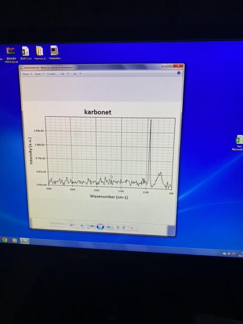

I also tried the sodium carbonate and get a nice spectrum. Also added the picture

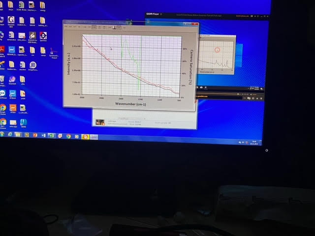

But not every sample I have, give a raman spectrum. I tried with the grapphite and got nothing.
I also tried lithium metal oxides and not able to get a spectrum.
In my experience the light coloured samples gives raman spectrum but not dark ones.
Have anoyone ever experienced similar issue, if so can you give me any pointers to overcome this problem.
